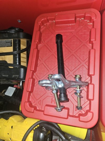

You'll need something to pull the steering wheel with. I tried to borrow a tool from AutoZone, they didn't have either option to loan. I bought one, but needed some extra washers/nuts (I least think I did). Here's what I used (don't remember part number).
