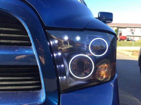

Here are some pictures of mine. They are spider headlights that I opened up, painted them black, added new LEDs,LED Halos and upgraded the projectors to Morimoto (spelling) projectors.

They work great, especially once I took all the insides out and replaced everything. I have 55w Hids in mine and it`s no issue, however I am not lifted. You may have to point your lights down a bit.

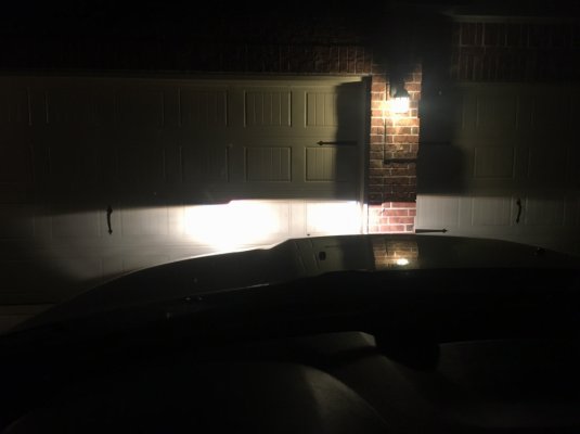

you definitely have to watch ebay specials, on the 4th gens the ones that come with Halos are OK at best even with HIDs, and to add to that they are a pain to adjust on most sets, there are some that have decent output but dont have halos, i tested a set and they worked great, but no halos or anything but they were black, and yes the rams that came with projectors had a different wiring harness on the trucks and thats why the listings say that
Demon-HeMi
Dec 30, 2010
4,346
3,300
Houston
2003, 2003, 2008, & 2013
(2) 5.7 HEMI, 3.7, & 3.6
My non halo ebay black projector headlights
And had really nice output
