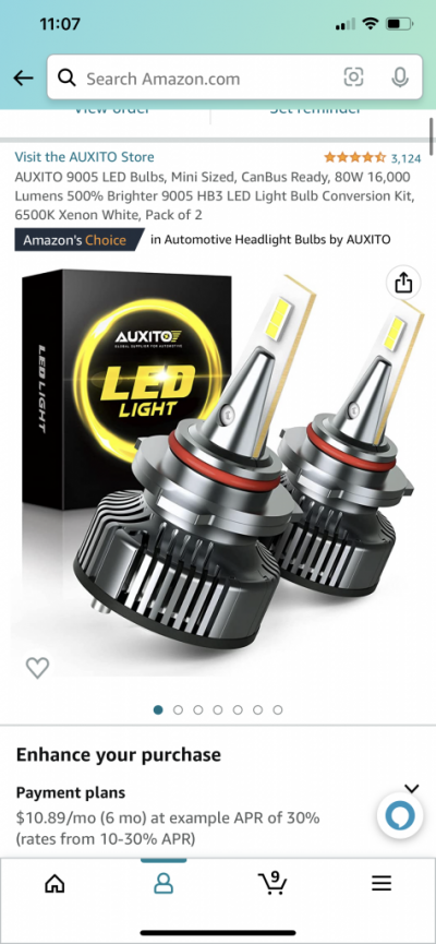

Halogens are junk IMHO. That's the first mod I ever do to any vehicle, upgrade the lighting. LED or HID, whichever will work better with the housings. Just did all of them in my '17 Sport, Auxito low/high 9005s and aftermarket fog housings with built in LEDs. The output is awesome, I need to remember to get a picture of it

Looks clean. Should try HID kit in those projectors, LED’s don’t “project” as well in that housing. And with the fog light drop out option on AlfaOBD..crazy bright.

I debated, but I did this same brand in my Ford Fusion with factory projectors and was impressed. I may try some HIDs too to compare but I’m very happy with these Auxito’s. They finally got the LED design/chip placement very close to the placement of the filament of a halogen so they work well.

I had Auxito for my low beam in my 2015 Dodge Ram 2500 quad lights. Kept getting people flashing there brights at me. Tried to lower them as much as possible. Still got flashed. The LED's output and spread is great. Getting consistently flashed back and being blinded by the other driver, not so much. If the light was halogen in the begining, then LED retro fits will fit, but not work well as I found out. Went back to halogen lightning and re aimed the lights. The yellow tint of the halogen lights is better in poor weather. Snow, Rain, fog anyways. The best lights are yellow in that weather which I have in my LED fog lights. I did however, put in LED's in the high beams. THAT was a game changer for off road and rural roads and the occasional rude driver.
