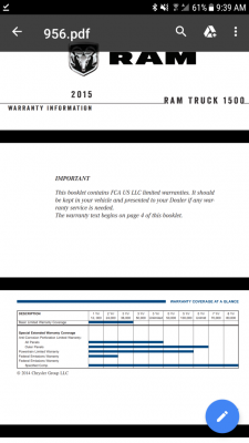

I'm trying to confirm if it's 5/100k I thought it was but the dealership I work with is claiming not.

Go to another dealer. Verify your power train warranty. If you are still covered have them do it for free.

You are covered under the 5/100k powertrain. I have had my 15 in twice for manifold bolts, both times with over 80k on the odometer.
