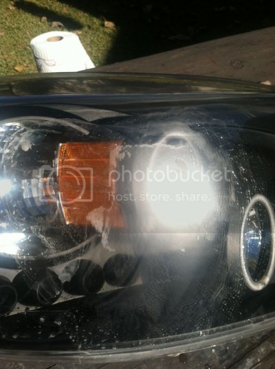

How they started, something got on the lens and ate the clear off in a square, weird for sure

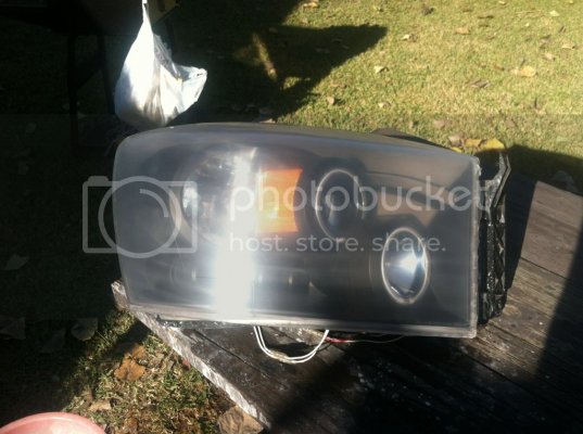

After various stages of sanding with many different gritts of sandpaper i had this, and this is what i applied the wipe new to....

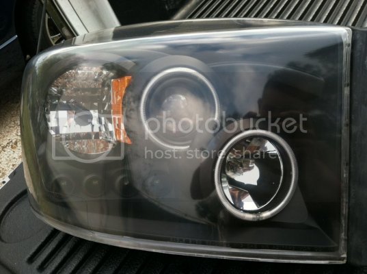

Final product
Nice, shiny, and clear!

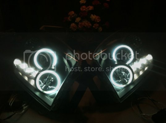

And with the halos lit up

600 to sand through the old bad clear coat, then worked my way up from 1000, to 1500, to 2000, then finally 3000 and then applied the wipe new, the problem with 90% of the headlight restore kits is that they either mask the bad area or get you half way there because they have you sand then polish but you never actuallY seal your lights, the wipe new seals the light with a new clear coat, if you dont seal your lights they will be nasty again within a few weeks to maybe around a few months
