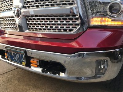

Here as you can see it spreads badly at as little as 20ft and has no focused center to allow it to actually reach out received_539055973240647.jpeg
