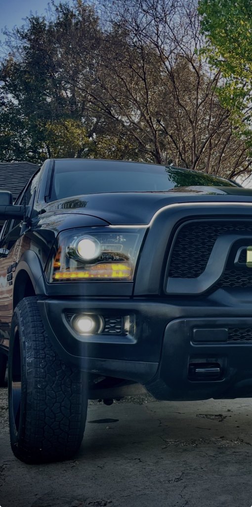

Hello everyone I have a few questions
Are these stock projector headlights?
Everything I look up says that my model shouldn’t come with stock projectors..
I want to purchase aftermarket headlights
But they all have a heads up that they won’t fit I have stock projectors?

I've got a 23' Warlock and my headlights are the same as yours.
Quality aftermarket headlights are not inexpensive, and "may require" the AlphaOBD system to make possible adjustments so the truck likes what you've done.
Morimoto and AlphaRex are two that come to mind

Yup, those are Projector Housings, same as mine.

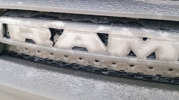

Be aware if you go led and live up north where it can ice they may need a way to heat up the front lens... I changed my lows to led but not the highs to keep ice from building up and making my lights useless.

That was from a miserable 13+ hour drive of ice, sleet, and snow through Colorado. Over half inch of ice accumulation in spots. Turned down the sun visors and blasted the defrost to keep ice build up on the windshield and still went through 3 jugs of deicer washer fluid. Got so hot in the truck I rolled down the windows. Had to use the high beams to de-ice the lights. Not the only time I've had to deal with ice but it was the worse.

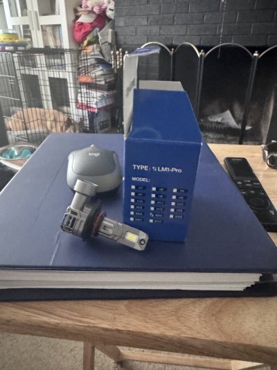

I installed the low beams a week ago. Then the highs today. Guess I’ll see if there is an issue. Fahren leds’ the cheapest on Amazon. Pix coming
Do I have zero issues. Really happy about that. Picked up these. I hope they are plug and play w/out the adapter as well.
