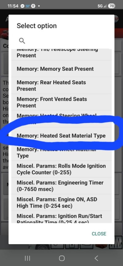

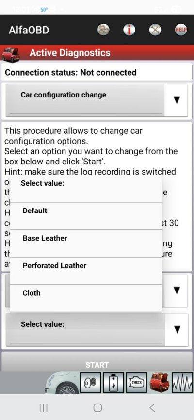

There is a setting in the Body Computer you can change with Alfa which deals with the Material Type of the seats, cloth, leather etc. How fast it gets hot and hot it gets is based on the seat material type. Same for the heated steering wheel. Cloth settings are colder than leather heated/vented.Is there a setting in the computer that we can change with AlfaOBD when the seat heaters work in relation to the ambient temp outside?
