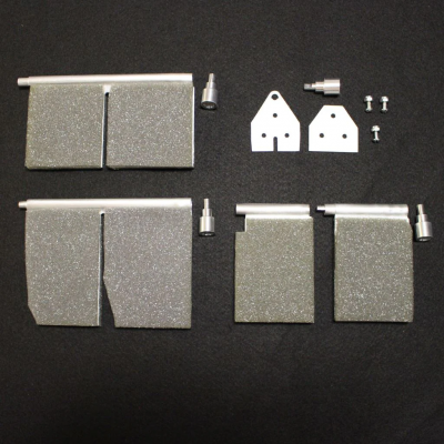

If you pull the HVAC unit & disassemble it on a bench, it would be silly to not put in new doors & replace the foam
There are a couple of companies that make the doors inside of the HVAC system
Dorman makes a cheaper set, but not the worst
this company likely makes the best & the most expensive, except for may be Mopar brand
Blend Door USA, made of aluminum

There are more than one place to order from,
I believe that these are for the 4th Gen Ram
( single or dual zone, $315.00 , there is a discount code on the site )
( discounts under Sales & Promotions )
