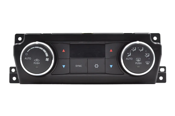

I have to ask, is your HVAC Single or Dual Zone
DUEL ZONE HVAC, looks like this & has the word SYNC on the control unit
single zone
my 2009 Dodge Ram 1500 SLT had the DUAL ZONE HVAC
I liked it because, i could control the amount of heat or cooler temps on either or just one side, or both sides
I could also send heated or cooled air to the rear seating area, the vent was at the rear of the floor console, or in some cases the front center seat

It has the DUAL ZONE HVAC
DUAL ZONE HVAC, looks like this & has the word SYNC on the control unit
single zone
