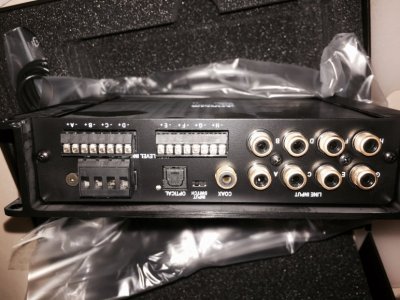

Who's jealous besides Brad?

I will be selling my Helix DSP. wink wink

Ahhhh, c'mon man! I just got done installing everything today, now you gotta tempt me like that!!!
That is beautiful (German built) piece of equipment! Congrats man! :favorites13:

Having owned the C-DSP version, it's not as big or as heavy as the C-DSP. I like the input sensitivity controls on the C-DSP with the clipping lights. That was a nice feature that let you quickly match the input level.

So I didn't know what this was. So I looked it up. That is one cool piece of equipment!

I'm not sure how I missed this....
What u think of it so far. I'd say the upgraded software is almost enough to justify the extra cost..

Installed, not sure it's worth the $400 extra. Setup is nice with the drag and drop features in the configure screen. EQ pretty much the same. The .25db gain adjustment is pretty nifty. Time alignment works similar to the original version. The 10 inputs were nice which allowed me to use the factory sub hi level.
Input A +/- front dash
Input B +/- front dash
Input C +/- front door
Input D +/- front door
Input E +/- Subwoofer
Input F +/- Subwoofer
Outputs A & B Tweeters Gain -4db
Outputs C & D Midranges Gain -4db
Outputs E & F MidBass Gain -7db
Outputs G & H Subwoofer Gain -5db
