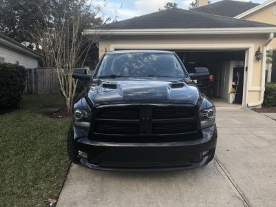

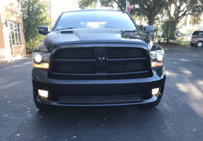

hey everyone - i bought my 2011 ram 1500 sport about a month ago with 70k miles on it and joined here right away. ive been reading up on things and love all the good tips ive found. my favorite is definitely the tailgate assist!!!!
so anyway - my headlights are horrible at night (misaligned too) and i came on to do some research about replacing them and realized there are some mods that i know about but maybe others that i dont even realize yet... like are my headlights stock? i have seen that some years offer projector and reflector variations but were the projectors available in 2011? its a true "Sport" from the VIN but was not blacked out version.
Things/mods im aware that the Original owner did (by observation only):
~painted all emblems to match truck color
~painted grille insert (is chipping - nto sure if i will redo or replace)
~aftermarket wheels and tires
~painted brake calipers (going to redo)
~painted exhaust tips black (have removed most of it)
~LED license plate lights
Mods i've done:
~added tow mirrors to replace mismatched and banged up mirrors
~tailgate assist (love!)
~powdercoated matte black/orange wheels to glossy black
possible mods -
~different headlights?
~different foglights? (look stock but illuminate half way into the trees when on and have a little gold inline resistor behind the bumper with black electrical tape so theyve been modified somehow)

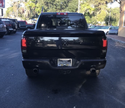

~LED taillights?
anything else that you can confirm or suggest i check out?
thanks for your help. Since i plan on keeping this truck for a long while and want to do something to correct the headlights, identifying whats already been done will help.

For starters, you have projector headlights. I wonder if the prior owner put Leds in there. Leds in projectors may be the cause of your lighting issues.

2013 was the first year for those projector style lamps and LED tail lamps. They came standard on Sport and Laramie (and up). Any trim in 2011 would not have had them.

Your truck came stock with quad headlights. Previous owner put the projectors in. with those projectors and a drop in hid kit you can get very decent light output. There is adjustment for up and down alignment for the headlights so that can be fixed without replacing the whole headlight

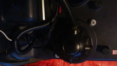

Yeah, if they put leds in them, expect a hole in the dust cap, maybe like this. I had to get creative to plug the hole and clean these projectors up and get them back in good working order. The guy who owned them before made a mess and I had to rewire everything. Good luck, hopefully you don't have a sloppy mess.

That truck looks great, you can look into getting painted mirrors too. I think they would blend in much better
