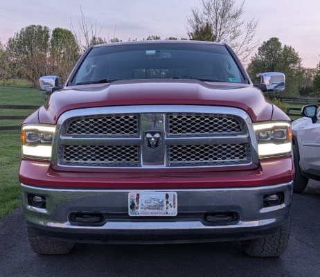

Has anyone installed the AlphaRex Black LUXX LED headlights (Part #880539) on a 2012 RAM 1500?
I am trying to get the daytime running lights (DRL) working.

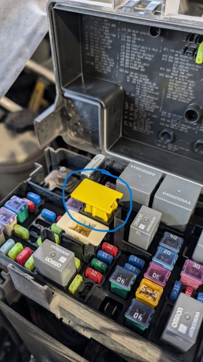

The fuse from M19 is too wide to fit into the second slot of the fuse tap. (photo for reference)
The fuse M16 is the large yellow block. (photo for reference).
I am not sure how I connect the fuse tap into the fuse block on my 2012 RAM 1500.
Might anyone know which fuse to use for the DRL?

You'll need to find a circuit that turns on with the vehicle ignition that's the same size as your fuse tap or buy fuse tap that fits the fuse you have. Amazon sell multi packs of the fuse taps that have different sizes.
