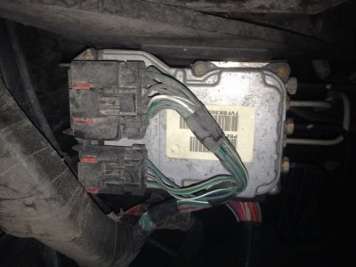

So my ABS module failed and I am having it repaired.
One of the connectors that goes into the module has a really bad case of corrosion.
A couple of forum members mentioned cutting out the old connector and splicing in a new one.
My question is, what's the name and part number for this connector? My Haynes manual and the service manual I have aren't helping me out.
The first photo is the ABS module and I need to know what the big connector on the top is and where I can possibly order a new one. Would like to avoid the wrecking yard but will go that route if the new part is cost prohibitive.
The second photo shows the connector with the corrosion. What is this part called? Where can I get one new?
Any ideas on part numbers, where to pick up a new one, etc...?:help:

After seeing your pics, I would strongly suggest cutting out any and all connectors that show signs of corrosion and or heat. Suspect you might find connectors at the local Ram Dealer. If not, any local , Napa, Auto Zone, etc should have the connectors in stock. Only problem I see is that as far as the connector block, you will have problems with using a new one as any wire that exhibits heat or such will have to be cut back to a point where the wire is undamaged. Guess short of purchasing and installing new harness(s) "Lots of work" (unless you can get the OEM terminals)I would bypass the connector block with any damaged wire or terminal. Think you were lucky as the connectors , as luckily most are, was the weak point in the system. Ps. when you solder in the new connectors, make sure that "Rosin Core" solder is used and dielectric grease is used on the terminals when re connecting. Just a thought.
