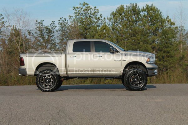

Thanks for all the feedback guys. I think my mind is/was made up even before I posted this thread. This is the truck that probably ruined me for avoiding 37s, just love the look.
Amp tires seems to make one of the lightest tires at 78lbs which isn't terrible. We'll see how it goes :)

can't wait to see it and you won't regret going with the 37's
