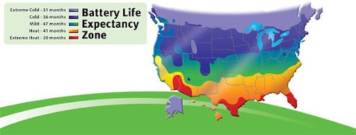

You know the worst state for battery life?
Florida has most of the state in low battery life zone.

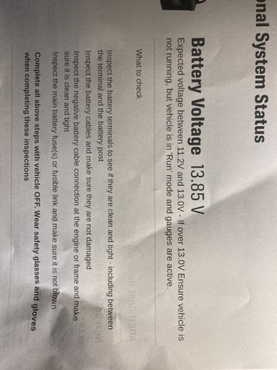

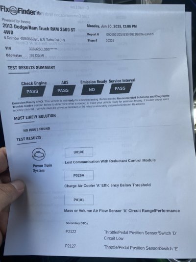

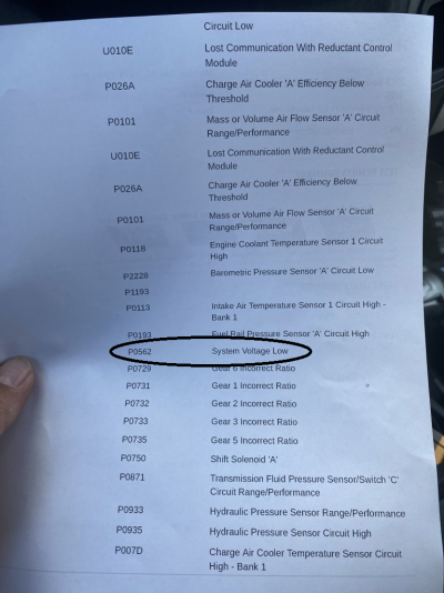

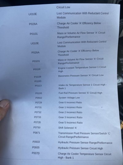

Thanks! The active airbox service required see dealer, service airbags, and service tire pressure monitor happened after I had the motor replaced, the codes showed after my transmission was replaced. How should I flash the cpu or would a tune from ez lynk do it? Also, this was with the printout when checked the codes. Again, thanks for all the help!IMG_2921.jpg

Thanks! The active airbox service required see dealer, service airbags, and service tire pressure monitor happened after I had the motor replaced, the codes showed after my transmission was replaced. How should I flash the cpu or would a tune from ez lynk do it? Also, this was with the printout when checked the codes. Again, thanks for all the help!View attachment 568892
If that's a "not running voltage" test on the batteries,there's something screwy with your batteries.There's 6 cells in a 12 volt battery and they should each put out between 2.1 and 2.2 volts each for a grand total of 13.2volts at most,at 13.85volts somethings up with the batteries.Buy yourself one of these old school toaster style battery load testers,and disconnect the batteries and do a load test on them yourself.
