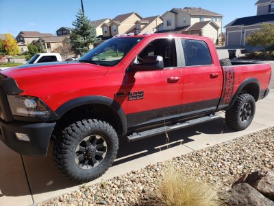

There's quite a difference between tire manufacturers advertised 35" tire sizes. The BFG KO2 35 12.50R17 has an unmounted specification undersized diameter of 34.5", whereas, the Kelly Safari TSR of the same size is stated at a whopping 1" taller at 35.5" or 1/2" oversized. The majority of the other tire manufacturers such as the Toyo Open Country M/ T are specified as 34.8".
Happy with my ST Maxx tires due to they are specified 34.06" for a 285 75R17. 34.06" is an oversized tire and is actually equivalent to a 285 76R17 size. The majority of other tires manufacturers including BFG run their tires in the 285 75R17 smaller, except for Toyo. As mounted the tires with 4,000 miles of wear measure in at 33.25" across the center. Basically 33". KIMG0472.jpg
Happy with my ST Maxx tires due to they are specified 34.06" for a 285 75R17. 34.06" is an oversized tire and is actually equivalent to a 285 76R17 size. The majority of other tires manufacturers including BFG run their tires in the 285 75R17 smaller, except for Toyo. As mounted the tires with 4,000 miles of wear measure in at 33.25" across the center. Basically 33". View attachment 143229
