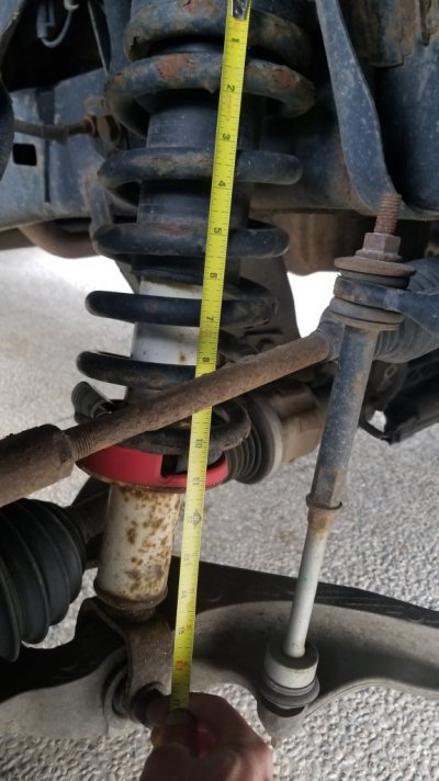

Take pictures of the front springs and shocks. Some more info is helpful

Thank you for the good suggestions. The truck is a 2013 1500 sport. 20230619_171403.jpg20230619_171451.jpg

Those are factory length struts up front. Those did not come with the lift though and are not factory struts.

You could go to a full length 2.5 coil over. That would certainly help and fair better than what you have now. It will ride better on and off road as well. Message me if you would like a quote
