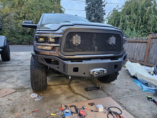

I literally just did this while you posted this. The attachment will be the same as any 5th gen.
Essentially 4 bolts each side total of 8.
For sensors and lights you will just have to look to see how it is clipped in. The instructions are basic but everything you need to do is basic as well.
FYI wire your winch in and sensors before you mount it. I used a floor jack and balanced the bumper while jacking it into place.20231015_183233.jpg
