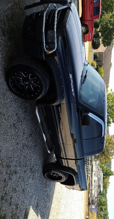

I got a 2001 dodge ram 1500. 5.9 magnum. And when I accelerate, it kinda surges at 2100 RPMS. Like, it'll jump up to about 2300 RPMS,then back down to 2000, then up to 2100 RPMS again. It doesn't do this at any other range. Before and after that, it's perfectly fine. At first I thought it could be a fuel pump or injectors but when I mash wide open on the gas, it doesn't do it at all. And it only does it when the truck is warmed up. You ever heard of anything like that?02861d2d05b717c34d796450f0d0af82.jpg
