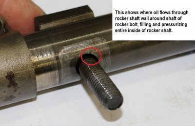

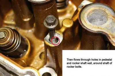

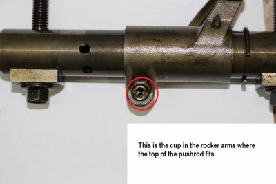

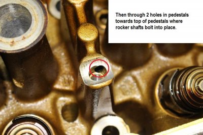

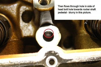

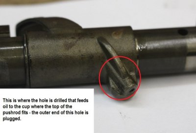

I've always worked on Chevy engines and now that I've built (2) 2004 Ram 5.7 Hemi engines, I find the valvetrain oil flow path interesting and a bit complicated.
I couldn't find this information anywhere else online, so figured I'd add it here for reference for anyone interested.

Wonder if anything has changed since then, Gen II, Gen III, etc Outstanding explanation!

One of the best posts ever. Thank you so much for posting this. I was looking for some explanation on clearing up oil pathways in my 5.7Hemi and this absolutely answered all the questions.
