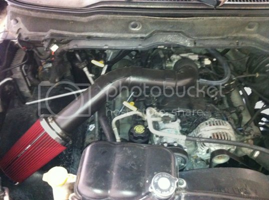

Figured I'd give it a shot...paint didn't turn out so well, but it should perform a little better.

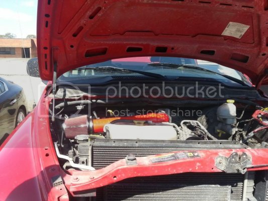

Just took off my old Ebay intake... I had the sensor held by black Sealant silicone. After four years, I'm impressed how good it held. I had to use a knife to cut it out of the chrome aluminum tube it was in. It also took me a while to get all that silicone off of the sensor, which by the way, still has some on it. I was finally able to get around and install my 3" Electric conduit DIY intake... Will explain more about it in the next post (With pics)

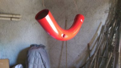

So after reading somewhere about the "Black Mamba" CAI, I decided to build my own. I'd like to give credit to the inventor of this DIY Cold Air Intake, unfortunately, its been so long since I've read about it, I don't know who came up with it. If any of y'all can remember him, please do comment his name, as he is to be credited.
So what's a "Black Mamba" Cold Air intake?
Well its an 3" 90Degree bent PVC Electric Conduit tube. You can find them at any hardware store, and under $10 dollars. One end has a 4" Outside diameter entrance, which will hold a 4" K&N air filter very well. The 3" end with a rubber coupler will match the Throttle body's mouth as well. Pretty neat as it is a one piece CAI.

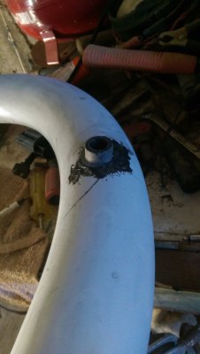

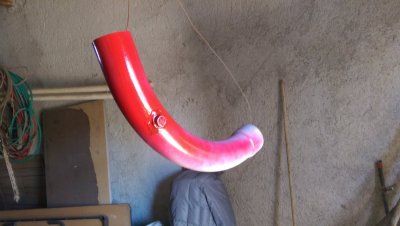

When I bought my 1st CAI off of EBAY, I had my HEMI hat removed, hence not having a sensor plug on it. I then lost the HEMI Hat. That's what stalled me from installing my DIY "Black Mamba" intake for quite some years, even after having all the components at hand. I've recently found the hat whilst cleaning the garage, and decided to take off the sensor plug. glued it to my DIY CAI tube, and painted the whole thing red, to match my truck. I think the whole setup looks good.
Gluing Sensor plug to PVC Pipe
Painting the assembled tube (PVC Tube + Sensor plug)
_______ See next post for more!!

... More paint
