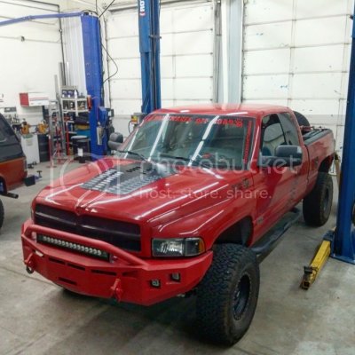

469ee4fc2257ac3172ebdbec82e8b817.jpg its a fiberglass scoop. What kind of bonding apoxy do I need too put between the steel and the scoop?

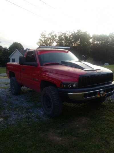

8a1584d147d943af9a499a3ad4e2d087.jpg thanks bro! I'm excited. I Just wanted something different lol

Have you thought about riveting it on like they used to do with scoop on the old cobras, the rivets actually become part of the design plus it ain't com'n lose. Just a thought.

This is a good suggestion, If you try to make it look like its not a bolt on scoop then you will spend a ton of time and $$$ to get it to look good and you might as well have spent that $$$ on a cowl hood in the first place... Paint it to match or how ever and rivet it on and will look better IMO.

Trey has a point. Line it up and tape it in place. Drill 1/8" holes and rivet it down. If you're good with body filler and fiberglass you could even have it transition into the hood and look factory made

I'm no paint and body man, please chime in if you know, but molded in filler between metal and fiberglass is going to crack eventually from what I've been told. Go black like your stripe and use silver/aluminum rivets, that would look killer!

If you get the basic shape down with fiberglass and use your filler over that you should be good. Be a lot of work though.
I just did the Jeep louvers similar to Nightmare not long ago. Used rivets as well. I like it.

Bondo is a no go. Fiberglass or "Kitty Hair" is what you'll want to use.
Alternatively like as mentioned, you can leave rivets or sheet metal screws exposed. I love how it looks on mine. When I get ready to do body work and paint I'm going to fill the lines in the hood to make it flow a little better, but for now it still looks pretty good.
