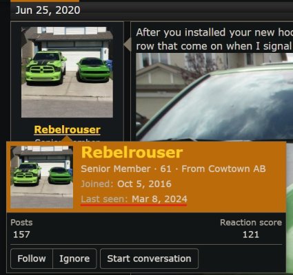

Were you attempting to gain Rebelrouser's attention concerning his hood mod?
Unfortunately, he hasn't been seen in just over a year now.
I'm confident other members could coach you through the project if you requested it. :cool:
