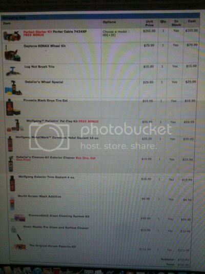

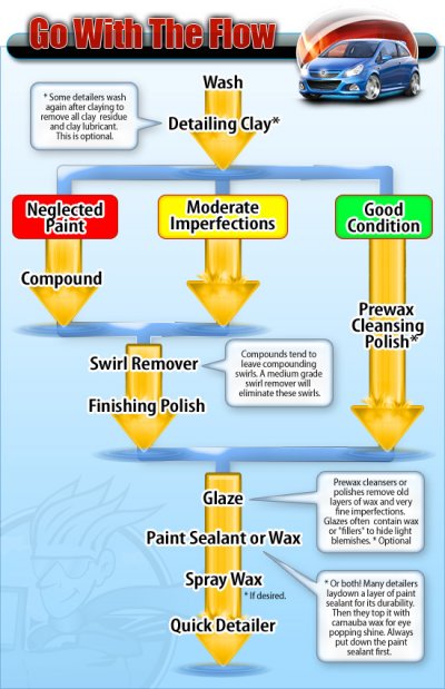

This is a list I came up with from reading the detailing tips and tricks area on autogeek
