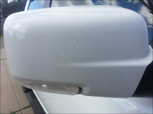

Bugs, dirty and dust throughout
Mirrors always get hammered

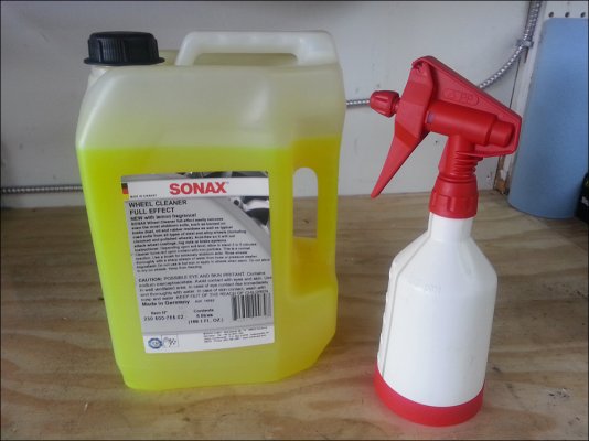

Then I hit up the wheels with Sonax Wheel Cleaner. This stuff smells terrible, but works wonders. The product is sprayed on green/yellow, and after 5 minutes or so will change to a redish/purple once it comes in contact with any iron from the brake pads/rotors etc. so you know its working.

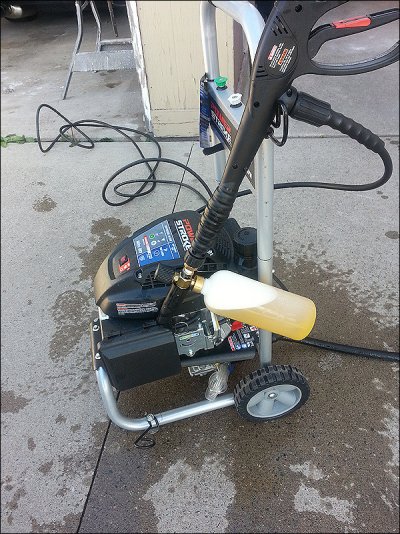

Gas pressure washer, Uber foam cannon ready to go. I LOVE this setup, makes washing so much fun.

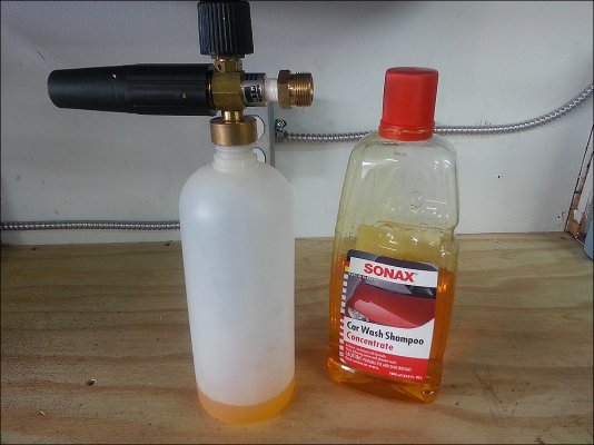

Only need about 1/2"-3/4" of product, fill the rest with water. Sonax Shampoo is great in the cannon, and is safe on sealants - won't strip wax or coatings and leaves a great gloss shine when finished.

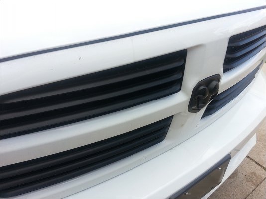

I hit up all the tight areas, window trim, mirror housings, grill etc with my Uber Detail Brush.

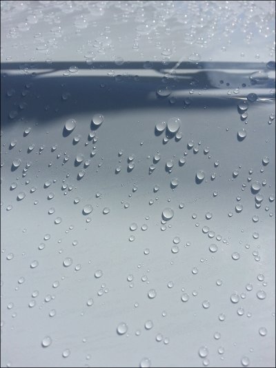

After thoroughly washing the truck, give it good rinse. Nice beading action from the previously applied sealant.

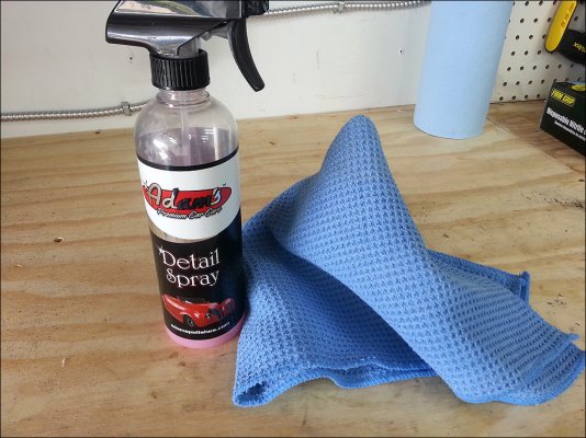

Now, to eliminate the chance of hard water spots, it's time to dry. I use a waffle weave towel and Adams Detail spray.

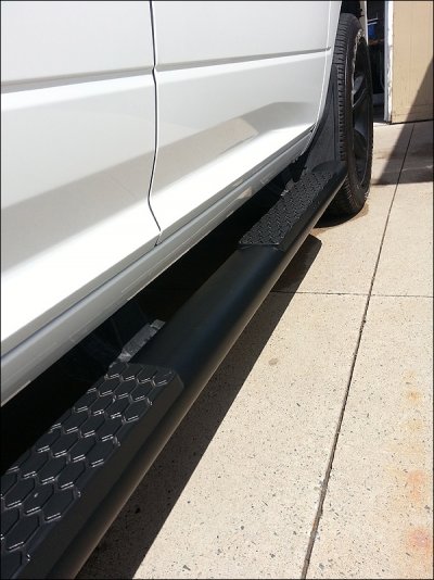

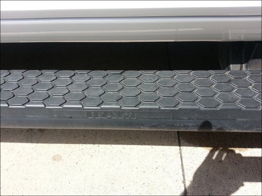

Next up was the faded running boards. I hit them up with Adams SVRT, and applied it with an Auto Finesse Foam applicator.

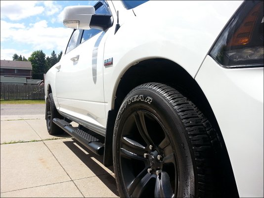

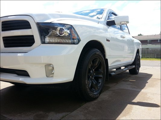

Finished version. Not perfect, but looking great, nice gloss to it, and I know it's protected with the products I use.
Tough to see, but nice cloud reflection on the hood.
