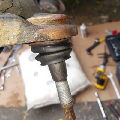

Ordered some bil 5100s two weeks ago along with new uca's. $320 out the door with everything. I run a super tight schedule between work and finishing my BA, but I had Monday morning off (work midnights) and decided to get after it. The idiot before me installed spacers. I had to used a spring compressor just to get the struts out. Right UCA was toast thanks to the spacers. Got it all tore apart and was ready to disassemble the stock struts. Everything went to hell at this point. The spacers acted like a retaining pond and collect 3 years worth of water. The nuts were so rusted they didn't even have a hex head anymore! Tried absolutely everything. All my tools are at work so I was working with zero air power. Finally said F it and ordered new struts from Amazon, figuring I'd rob the parts and put it on the bils. (At this point I was willing to pay the $220). Well some how my expedited order didn't process in time so next day air was a no go.
Had 6 hours left before work and called every ram dealer hoping they'd have the mounts and springs....nope. A NAPA down the road happened to have a pair that a guy ordered and never picked up....thank God.
Problem #769 today: the quick struts are completely different that stock. No way the bils were going to work. I finally just said F it and installed the stock ones. All done within 30 mins....at the cost of $400. Unfortunately I had to be to work and didn't have a choice. 10 hours of crap and several hundred dollars later, I went from 38.75" fender to ground, to 38.25" fender to ground [emoji45][emoji45]
Alignment appointment in the morning. I miss my leveled look but it wasn't happening. Now since I used one of the Uca's from the kit, I can't return it. So my plan is to torch the nuts off at work and reassemble the bils on a bench. Wont reinstall until spring when it's warm and my wallet has recouped.
Real bummer but welcome to the rust belt. Literally spent 3 hours with a cold chisel trying to beat the nuts off.
