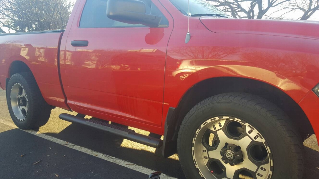

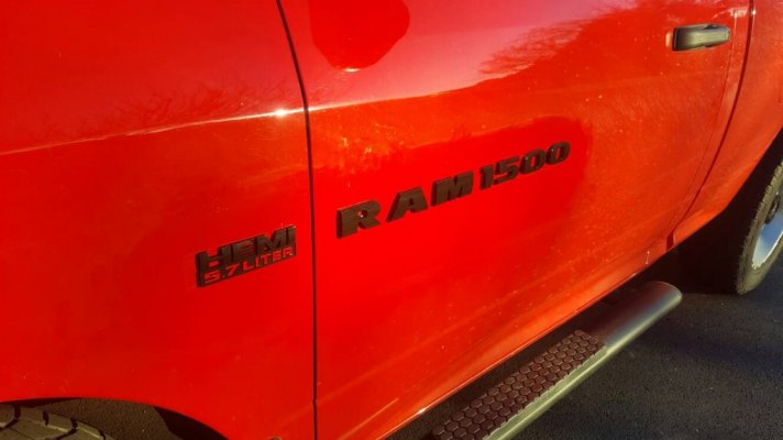

Just thought I would share what I did today. I removed my stock chrome badges and installed some new badges I got from Ebay.
Red & Black Hemi Badges and all black Ram 1500 badges.

Before you do anything, run a piece of painters tape along the top edge of the badges/letters you are removing so later on when you put on your new badges they will be straight and in the same location.
Now you can heat up each individual letter or badge with your heat gun. Be careful not to over do it or you can burn/melt the badge. Use your plastic credit card style scrapper and simply slide it behind the letter/emblem after you have warmed it up. It should go rather easily since it's warm.

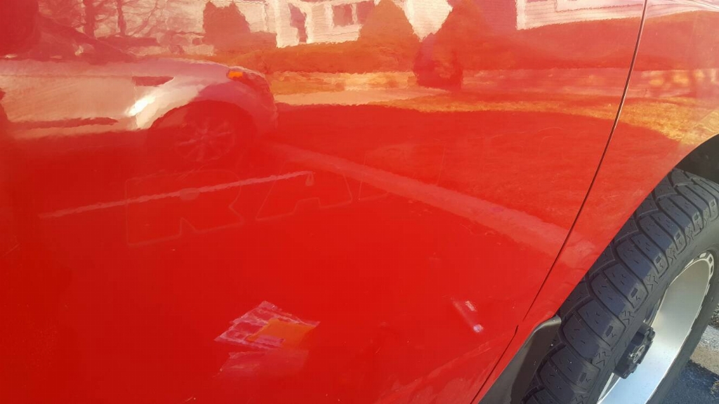

Once you have removed all the badges, you need to remove the glue left behind. Take your Goo Gone and apply it directly to the glue, making sure to hold a Microfiber underneath the glue to stop the excess Goo Gone from running down the paint. Let the Goo Gone sit on the glue for 2-3 minutes.
Once the 2-3 minutes has passed, use your heat gun and lightly heat the area with the glue. You should only heat 1 letter at a time while you remove the glue with your Microfiber and more Goo Gone if needed, then move to the next letter. Otherwise you will be reheating the glue a bunch of times as you go down the door. If you heat it just right, the glue should come off pretty easy. I didn't heat up the glue on my driverside and it took forever and was extremely difficult. Once i was on the passenger side I used this method and it went alot quicker and smoother.
Once you have removed ALL of the glue, use your spray bottle with the soapy water and a CLEAN microfiber to clean off all of the left behind Goo Gone and debris.
Take your time applying the new emblems. Align them with the painters tape you applied earlier and gently place them where you want them but don't apply any force to them just yet. Make sure you step back and check that they are positioned properly. It helps if you have a friend or buddy stand back a few feet and help you align them properly. If you have no friends or buddy's, then take your time and follow the edge of the painters tape. If you just kind of "place" them on loosely, you can step back and check them and if they need to be moved or realigned it won't be difficult to remove them.
Once you have your new badges where you want them, use a clean microfiber and push on them being careful not to push to hard and dent your truck. It's best to lightly warm them up with the heat gun before applying them, but not necessary.

Yea I guess wiping it with an alcohol pad would help. I used nice warm soapy water. I have heard of the fishing line method but I didn't have any laying around to try it. I ended up using a plastic "credit card sized" card they came in a kit I bought to apply vinyls to cars.
Either way. I used the same method on my last truck and the badges stayed on for the 3 remaining months I had it.

How To: Remove & Install New Door + Fender Badges...
Shoulda gone later 4th gen style lol. Yours look ok...little long for the door IMO lol.
Heat gun and fishing line. Decals fall right off
Yea I realized after I did it that I should have stacked them... I'm probably going to order a new set and redo them. They were only $30 for both.
