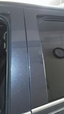

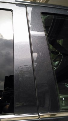

I have a new-to-me, low mileage, 2017 RAM 1500 Limited which was purchased from a non-RAM dealer last year. This dealership washed and waxed the truck when they put it on display, and I noticed that the black panels (applied film?) on the door pillars had a "mottled" white appearance. I figure this is residue from the waxing/detailing work, but don't know if a product can remove it and restore the black. I've gently rubbed the areas with soapy water applied with a brush but it didn't improve the appearance.
Attached are pictures of what I'm describing, one with flash the other without.
Can anyone suggest a method and product for removing this "blanched/bleached" look? I was thinking to try Meguiar's "Magic Black" but haven't done so yet (not so sure if it would work since it's meant for bumpers and plastic).
This is an unsightly "blemish" on such a nice vehicle and I hope I can get rid of it.
Thanks for your assistance and suggestions.
Cheers,
EAS

have you considered just pulling it off, its vehicle color matched underneath?

worse case, some later have added gloss black, or matte black back onto it with wrap if you dont like the color matched.

No, I hadn't considered removing the film as it LOOKS like it's tightly bonded to the door frame. But I won't know unless I try. What I'll do first, however, is drop by my local RAM dealer and inquire as to whether these panels can be removed and how to do that (heat gun, I'm guessin'). At the same time, I'll find out how much they cost to replace in case I need to go that route - a.k.a. "Plan B."

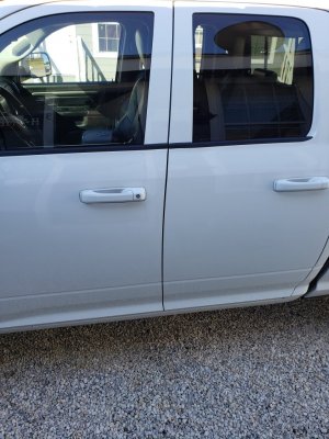

Took my vinyl off. Some take the vinyl off and paint the door pillars black, others will put vinyl back on.20200119_150519.jpg

Many thanks for your suggestions and photos in reply to my question. Following "Pull Ya"'s idea, I did find a DIY article on the Forum with several videos included which show how to take the vinyl panels off. Some folks used a heat gun or hair dryer to soften the adhesive, while others coaxed, prodded and pulled the material away. Pretty straightforward technique after all and yields a much better look. Great!

A while ago I promised to post a photo once I removed the discolored vinyl film panels between the front and rear doors. Well, I did the work and then neglected to take a picture. Well, here it is! The vinyl was a "trial" to remove but did come off quite cleanly once i got the hang of what I was doing. Truck looks so much better with those ruined panels off.
