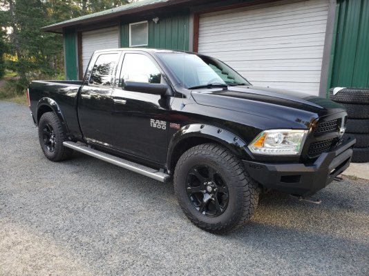

I put high quality 1.5" on my 2014 Ram 1500 and run 37's. As long as you don't buy cheap cast or pressed ones you will be fine.Rambo with front bumper.jpeg
