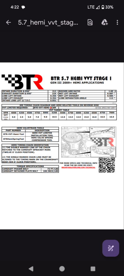

OK Guys, I have read, and read and read and watched MMX videos, and others and there is no general consensus on the torque spec for the phaser bolt on the 5.7 Hemi.
So I got a copy of the 2013 - 2018 official MOPAR Service Manual (ALL 14,000 off pages of it!)
Page 11437 is a Table of Torque Specs for the 5.7. It specifies 63 Ft Lbs.
Next - on Page 11521 it Specifies 90 ft. lbs.
And Finally - on page 11637, (which in step 3 above it tells you to go to the Chain and Sprockets section), it specifies 72 ft. lbs. (which is what I set mine to using the original bolt). And there is a LOT of controversy over using the original bolt! Some say you can, some say you can't.
So even in the official MOPAR manual there are three distinct values specified. So which is it? I really do not want to pull mine apart again and replace the bolt but I will if I have to.
P.S. I still don't have the truck back from the shop working on that dammed Anti-Theft No Crank BS!

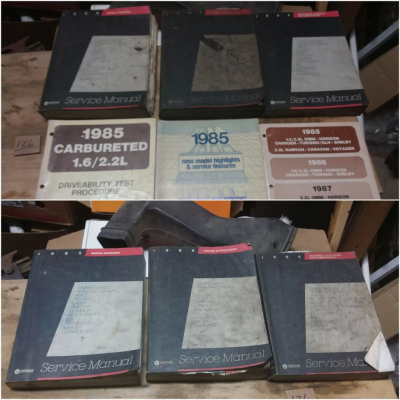

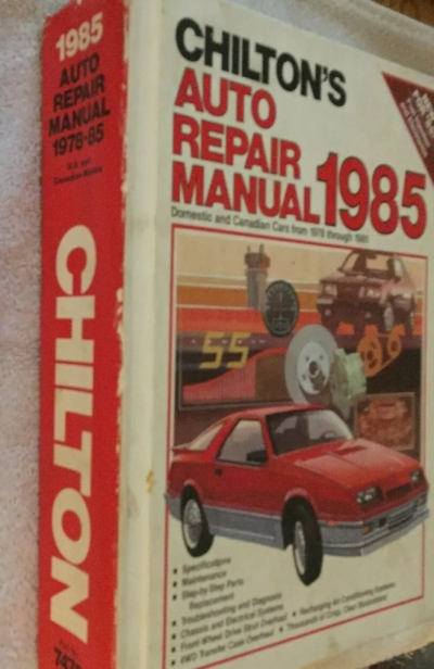

Personally,
i would not trust a current Haynes or Chilton manual that you can find in any Auto Parts Store, the ones that are about 1" thick don't have most of the DETAILS in them, when compared to their older manuals.
That book is suppose to cover, what the OEM Manuals have in them, most OEM Shop Manuals are 5 each, almost 1 3/4" thick books.
Chrysler/Dodge/Jeep/Ram has not published a written repair manual since 2008 or before that,
That is when the OEM manuals started being pressed on CDs
Mostly to save on paper & printing

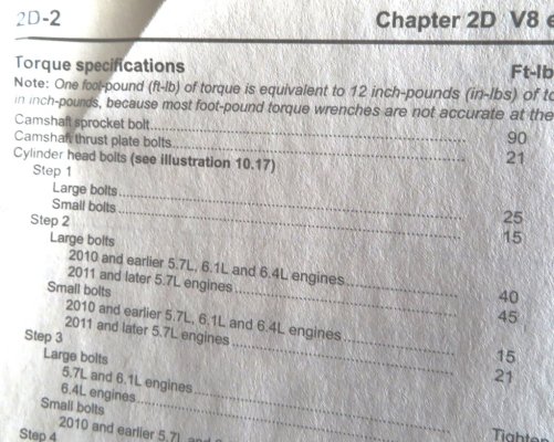

You're the one who posted the torque specs from the service manual a few years back,and even it stated 90 lb-ft.
A 10.9 metric bolt is a 10.9 bolt from pretty well every bolt manufacture,and most torque specs on a 10.9 X M12 X 1.75 bolt are from roughly 88 lb-ft to a little over 97 lb-ft depending on coating
