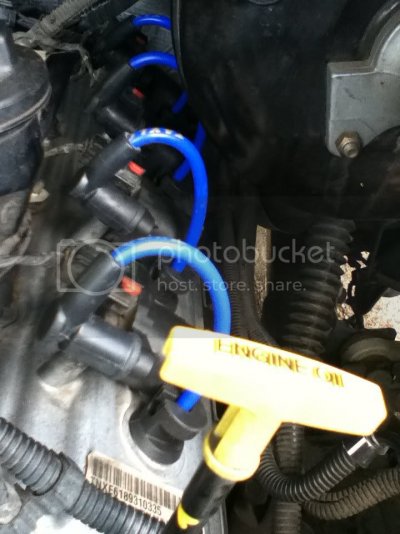

HemiBabe
Dec 6, 2010
7,214
922
DFW
Haven't changed the plug wires yet, but with the coil packs over the plugs, do u just replace the coil packs? Don't even think it has plug wires, just the coil packs that slip over the plugs??
Sent from my DROIDX using Tapatalk
There are plug wires, I got rid of the OEM long wires and went with Taylor Shorties
quietpeen
Jul 14, 2010
25,443
3,913
2021 TRX
Hellcat
on 06 and up there are no plug wires like there was on the 03 thru 05 hemi.
