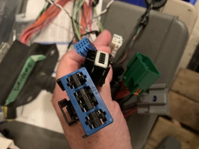

hey guys, how are you, hell, I'm looking for this connector and its door switch pins is to be able to open and close the windows and make the automatic side mirrors that lock themselves and open when you remove the safety or turn on with the oem remote control

I thought for a few minutes that I might have one of these for you. I have the door harnesses out of a 2014 1500 that I stripped a few circuits out of like the ambient lighting circuit, keyless etc. But the wires going to the door master switch for the windows/locks/mirrors uses a two connector system in the 14 and 15's, rather than this one large connector. So the door harness I have won't work.
That being said, a LOT of these different connectors appear all over the truck in various places. I have parts/all of several body harnesses, door harnesses, instrument panel harnesses, engine harnesses and others as well. If you can find this connector on a harness for a 2014 or a 2015, odds are I have it and don't need it.
The connectors are made by YESC or YESC/KAIZEN(?spelling?) and the pins are all common, 0.64, 1.5, 2.8 and 6.3mm. I just bought 100 each of the 0.64 male and female and a 100 each of the 1.5 male and female. I didn't get any 2.8mm as I haven't needed any and likely won't for what I am doing in my truck. I certainly don't need a 100 of each but that was the minimum buy for them, so I planned on selling the leftovers when I'm done.
So you can get the 0.64mm female pins for the connector from me, and if you can find that same connector on some 2014/15 harness and can describe which harness and where on the harness it is or send me a pick or tell me it is for and then I could look thru the 2 large black bags of extra wiring I have and cut it out for you.

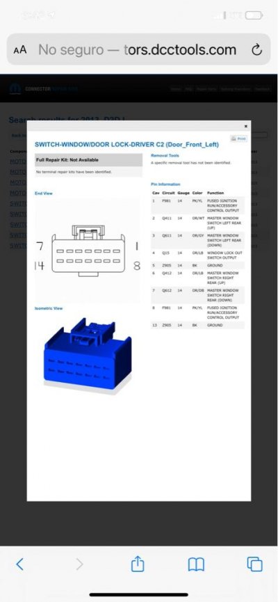

thanks I am also looking for these two but in males I do not know what they are I am trying to convert my connectors to a 2016 connector it sounds crazy but I want to see if I can make all the windows open and close together with the automatic side mirrors

Cesar. The certainly have the male connectors with wires and pins in them along with the mirror connectors and wires back to the door harness.
the female side of those are part of the 14/15/16 master window switch.
Give me an idea of where your located and I’ll see how much it is ship. I’m in Canada near Toronto. I’ll sell you the door harness for the 2014 for $15 plus shipping. If that sounds good to you.

you can connect the males with the females

Something to keep in mind, and I don't know how successful you'll be with what you are looking at doing...
The drivers side master door switch communicates with the drivers door module (DDM), and commands such as lock/unlock doors mirror movement and window up/down are sent from the DDM to the passenger side door module via the canbus network, rather than simple voltage on wires. But I'm no electronics specialist so I have no idea what can and cannot be done. But with all the changes to my truck, and things I've tried that worked and didn't work, I've come to understand a lot of how it actually works.
Just something to keep in mind.

I bought a complete harness of a 2017 it is almost the same, just change the connector of the master window switch, connect it and everything works well except the two back windows do not go down or up from the master switch or the rear door switches but they have lighting someone knows what my problem could be
