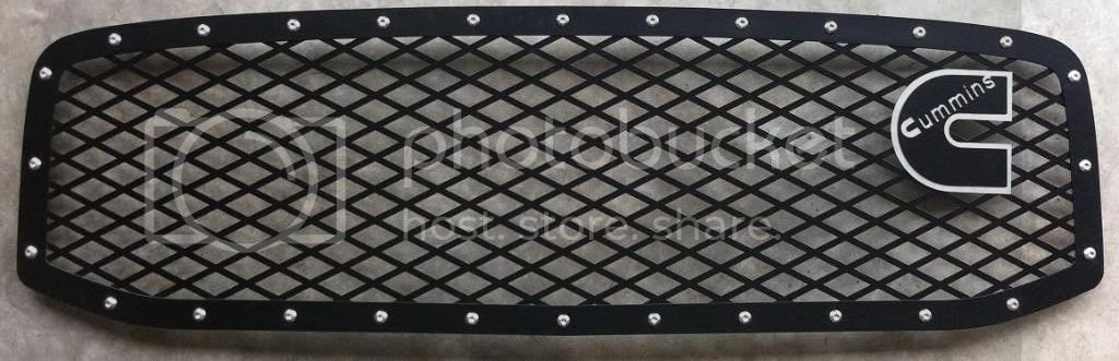

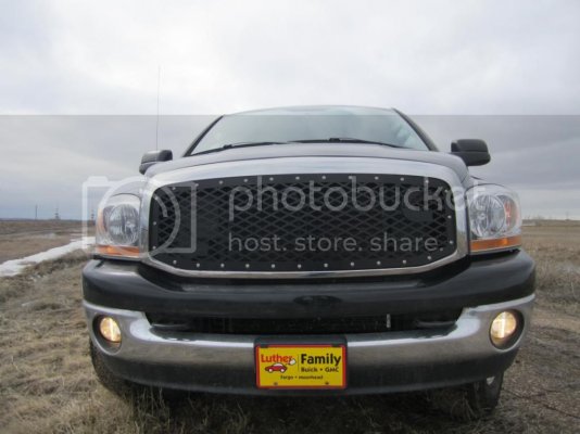

I was actually the first to buy this grill from rok-tek. The grills are 406 stainless, laser cut, two piece, and an optional emblem with stainless bolts and powdercoated. Im super happy with mine. after this photo he designed a stainless plate to go behind the emblem to help it stand out. I would buy it over again.
the way it installs is you take your stock grill and cut the cross hairs out leaving 1in nubs on all four sides. You then drill holes(I think it was 1/2in) in each nub that correspond with the bolts in the grill.
super easy to clean as well.
