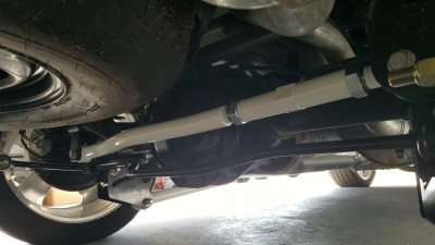

Its not a fun install at all but well worth it in the end. The brackets go hand & hand w/ a lowering kit for these trucks. W/o them the rear is all kinds of jacked up. Lol
After installing 2 sets now I highly recommend a right angle drill. I just used a regular 18 volt Dewalt on mine & what a pain in the ass. I installed a set for a buddy a few weeks ago & he had a right angle drill. Man that was a night & day difference for install. Made the install MUCH easier. W/o it you will fight the drill/bits the whole way through the install, curse, have thoughts on throwing a molotov cocktail through the window & burning the truck to the ground. Lol
I would get 2 or 3 unibits/step bits to get to the desired size hole for the 5/8" hardware. Getting from a pilot bit to 1/2" is a cake walk, getting from 1/2" to 5/8" in hardened steel is a pain in the ass. I would also buy 2 sets of good bits(pilot bit to 1/2") & a can or 2 of some cutting oil for the bits. When it was said & done on both installs we had a $200 pile of burned up bits each time.
My kit came w/ instructions, my buddies didnt but I already knew how to do it. Hopefully yours comes w/ instructions. If not just message me your phone number & I will help you through it.
If you have access to a lift use it. Much better than rolling around on the ground. If you use a lift you will need 2 big stands, like transmission stands, to support the rearend.
So your in for a full days worth of all the emotions. You will be excited you got them, pissed the hell off from the install, even more pissed off enough to have bad thoughts on life, might sit down and cry like a baby for a few mins b/c your so pissed off & at this point are injured from hitting your head on the rotor every few mins or having the drill lock up & pin your hand & smash it. But then the sun will shine on you, the install will be done & you will realize that wow, the rear suspension was completely out of wack before w/ the lowering kit & no brackets & you have a whole new truck. Lol
