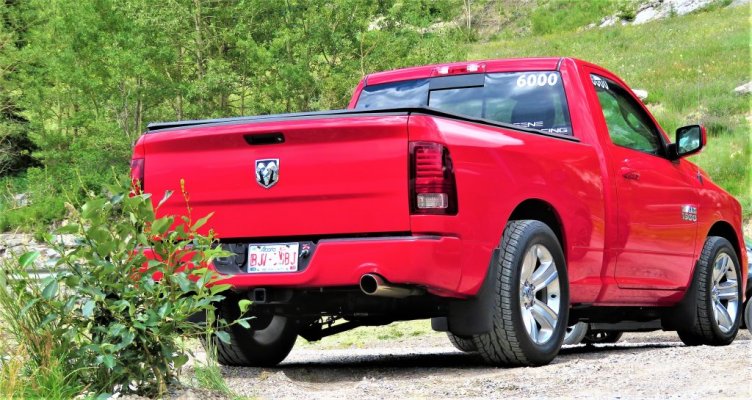

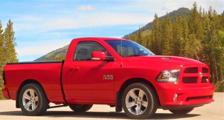

The No Cuts are a waste of time. Do it right the first time around. Steven Cooper in Saskatoon Saskatchewan used to build lower brackets to move the lower arms down,but he's no longer building them either.If you're handy you can build your own lower brackets out of 1/4" plate to relocate the lower arms down.Don't move the arms below the lip of the rim,otherwise if you have a blow out,and the truck drops down to the rim,and the lower arm starts to drag on the pavement,things could get real entertaining till the truck skids to a stop.
If you look close you can see my early Illicit brackets ,they hang almost to low,but they work,as the truck will hook on a skating rink
