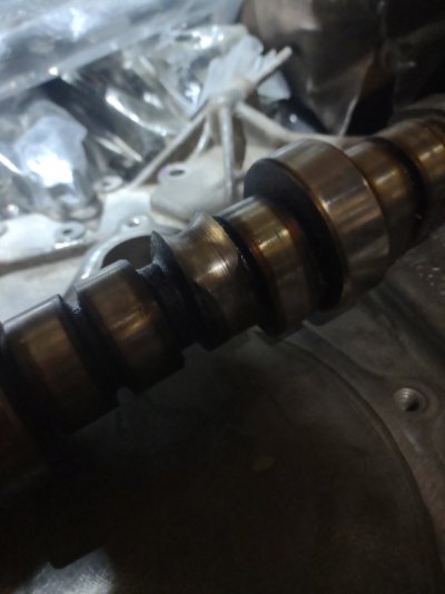

so this is my sister in laws 2013 hemi that has been snacking on it's own camshaft for who knows how long and after almost no time at all I've read the horror stories of dozens of owners havingsame issue. Dodge ram stelantis appear to be king douche bags for blatant ignorance and calculated disinterest in this issue.[/FONT] Shame shame [/ICODE]16922493062937602877218792639570.jpg16922493831708327608410984883040.jpg16922495335408126009505317699515.jpg1692249609781501398863738934959.jpg[/SIZE]

so this is my sister in laws 2013 hemi that has been snacking on it's own camshaft for who knows how long and after almost no time at all I've read the horror stories of dozens of owners having same issue. Dodge ram stelantis appear to be king douche bags for blatant ignorance and calculated disinterest in this issue. Shame shame View attachment 526647View attachment 526648View attachment 526649View attachment 526650
thanks for posting and sorry for the troubles. One large issue is the number of people who refuse to even believe how large this issue is, more postings more better.
