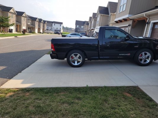

I'm going lower as the ride on 2/4 with springs, in my opinion, is not as good as the ride with the lowered control arms in front. I want my front end to align and I like the look of the 4/6 better.
Here's my truck on 20s, with the brackets installed.
Here it is on 22s with no brackets
As you can see, too much gap between body and tire
