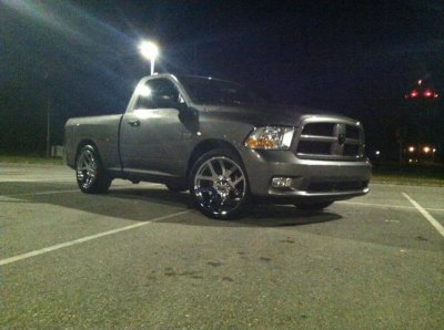

From my experience, all that goes into lowering a 4th gen is new springs, or cutting your current springs. I'm running 22's with a 4/7 drop now though. You want anything more than 3 inches up front you have to start moving bump starts and gettin a camber kit for it. I was also told I would prefer new universal ball joints with that kinda drop.zamu6aju.jpg

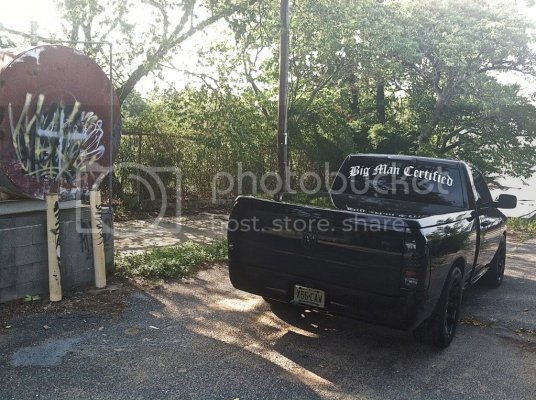

sorry for jacking your thread but everything they are saying is 100% true but just know that when you drop it you are going to need some time to settle, this picture is from the week i did my drop and my truck sits just about where trevs does so if you do decide to cut them give yourself an inch to settle. (Mcguaghys 2-4 kit BTW)

But on topic, that pic is literally less than an hour after we finished the drop, it settled maybe another half inch.

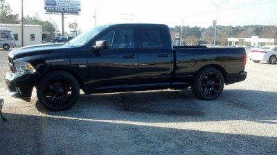

Valth,
Here are a few pics of mine with a 3/5 and 22's 305/45 tire
