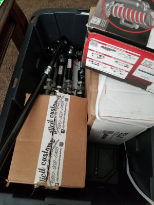

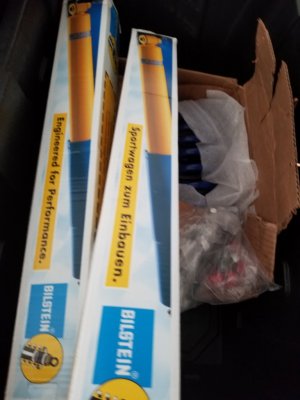

Am I missing anything? Any issues I may have? Good to go?
front
Gf springs
Bilsteins
F150 sway bar end links
Rear
Belltech rear kit (springs,bump stops,sway bar end links)
Adjustable panhard bar
Adjustable control arms
Illicit no cut brackets
Qa1 ts901 (do they work with no modifications?)
Hellwig rear sway bar
Helper bags

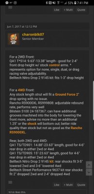

Screenshot_20180619-194144_Chrome.jpg They are both listed on the shock stickie. Does anyone know the difference between 901vs905 qa1

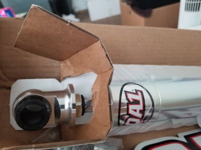

Do I need parts to make the 901 bolt right up?Screenshot_20180619-205345_Chrome.jpg

Like Gary said, the TS-905 is the one you want, and is a direct bolt in.

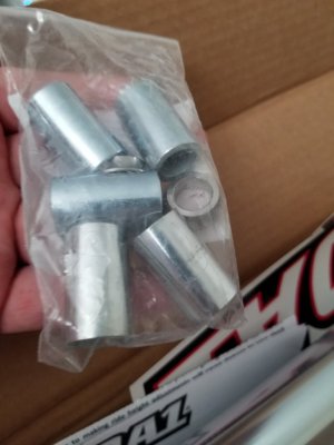

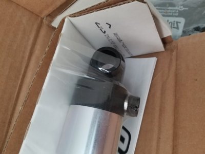

Did you get any more parts with the 901’s?
Specifically a steel sleeve with a 9/16” I.d. to press into the shock eyelet bushing
I would assume the 905’s already came with the correct sleeve (both I.d. And length)for the Ram factory shock bolts/mount....
Yea. Looks like their is 1- 9/16" i.d. per shock.
6speed4.7
Apr 21, 2015
238
129
Winnipeg
2023
That’s quite a selection
Hopefully one of those sleeves will fit inside of the existing shock bushing and have the correct 9/16” I.d. for the shock mount bolt.
To fit snugly in the shock mount on the truck, the sleeves should be roughly 1 9/16” - 1 5/8” long

Got a hold of charronblk he said it will bolt right in.it just has softer valving which is adjustable. He Is running td901s
