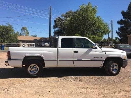

I installed a new fuel pump in my Dodge ram today. We removed 07b7599b2dc63979727144ed4d39cc2b.jpg1548bfb299798a06c3377a25d78ab759.jpg57c96a74ec3c2498432d4be9daf6dddf.jpgbf3a94942e7560267de004f41b978c62.jpg8f1be74975b69a35853aaeb37113eb80.jpgthe tailgate, spare tire, and all but the right rear bed bolt. We backed that one out 1/2 way.
We removed the tail lights and disconnected the wiring. There is a ground wire connection right behind the cab on the right side that we had to disconnect. Then we lifted and pryed The bed up until we could reach the fuel pump. It was quite an ordeal but all went well!
