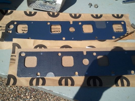

best bet is the one gaskets, the ones that come with the headers are usually paper thin, some have been known to blow out which means you have to take it apart and do it over again to fix the leak. the dealership had then for $28 for the pair when I did mine.

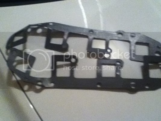

Post a pic of the gaskets they sent. Im willing to bet they are the crappy ones, we always use OEM gaskets for headers at the shop.

Definately worth it and with proper fasteners do not leak. I installed the Flo-tech ones and soon after was getting codes because of leakage and after 2 years of that took them off and changed them to OEM with 6.1 Thread locker treated bolts, problem solved. I did BBK's on my other Hemi (LX) last July and although the BBK gaskets looked OK I didn't take any chances and did same.....Zero issues on that set-up either. Have Fun! Good weekend for Modding for Sure!
These are as clear as I could get them. They really dont seem too thin, then again I am not sure what a good gasket looks like. I need to get these done this weekend because I have to drive up to upstate NY next weekend (6hrs) and my mom will not be able to handle my manifolds making noise haha.
I will check the dealer tomorrow to see if they have any oem ones. If not you think napa will have them? Worst comes to worst I will replace them if need be but I need to get this done this weekend
