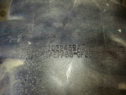

I have a 2002 4.7. It burning coolant. Checked the oil and it seems to be fine so I suspected intake manifold. I know its not an absolute that there would be coolent in the oil if it was the head but its more likely, in my experience anyway. I have a buddy who had a similar problem with his Chevy and his plastic intake had cracked and there was a cooling jacket in it. My question is, is this also the case with my intake..... is there a cooling jacket in the intake that could be cracked? I have started getting down to it and removed the air plenum on top of the motor and there was coolent in it.
Also.... it appears that my intake is no longer manufactured?
I see that there is an "upgrade" to an 08 intake from AirRam that requires a TB adapter. Is there significant HP gains with this? Is there a cheaper option?
