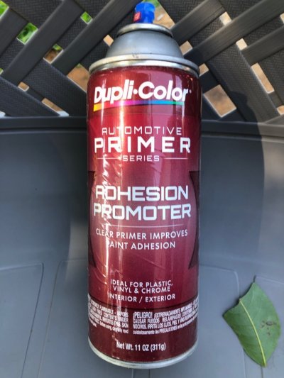

I use a bonding promoter/primer then a base primer(color corresponding)
i.e white primer for light colors red for red tones gray and black on dark colors
I prefer dupli color products for interior paint and rustoleum on exterior. 12a0fcd330d28b955dabc58127e65de4.jpg
Even exterior paint on plastic I begin with the adhesion promoter.
Added:: use dish soap and I water to prep everything before painting

+1 on the adhesion promoter.
I did exactally what your doing because when the sun hits that chrome it gets in your eye. Plus... I hate chrome. Scratched it up a bit w the sand paper, then did adhesion and then color match paint from Duplicolor
