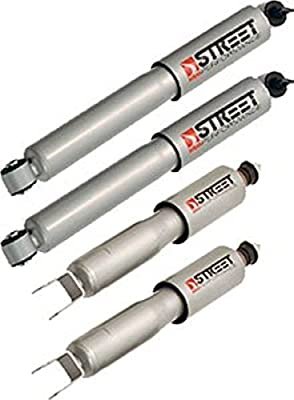

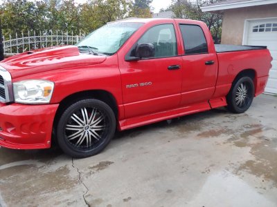

Lowered my 07 quad cab 1500 and have had problems with it riding ruff. I have the
Belltech 9543 Street Performance Shock Absorber Set
    But it still rides ruff. Thanks I appreciate any help.

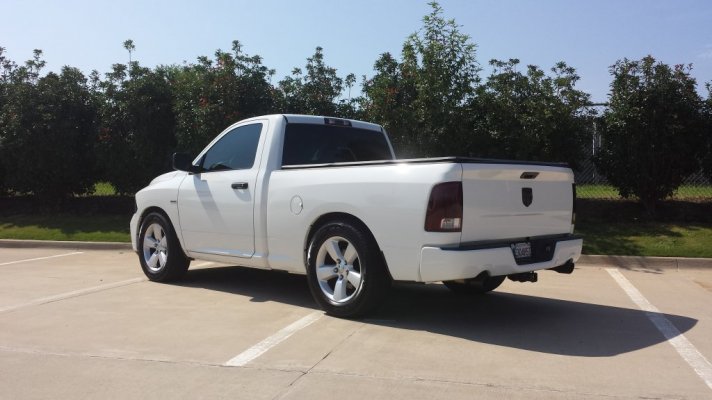

Yes, switching to air ride in the front will definitely make it ride better but it is still a truck. I have a 2004 Ram 1500 QCSB with an air ride setup in the front from X2 Industries. This is the most basic of air ride setups for our trucks and I have to say it does quite well. Here is the kit I used...
https://www.x2industries.com/produc...sion-kit-hd-bags-custom-brackets-no-fittings/
There is another kit from www.airbagit.com that I like the looks of but I don't have any experience with it. I'd definitely like to drive one of our DR trucks with a setup like the one below to see how well it rides and handles...
https://www.airbagit.com/Air-Suspension-kits-Front-axle-p/fbx-f-dod-61.htm

Yes the BT shocks are terrible, had them on my 2011. Finally swapped back to stock shocks up fornt, and I think sold it with them still on the rear. Chcek Bilstein on QA1.
