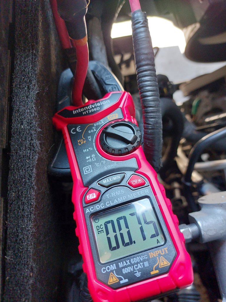

I like to use a DC Clamp meter. Then start removing fuses to isolate the source.
