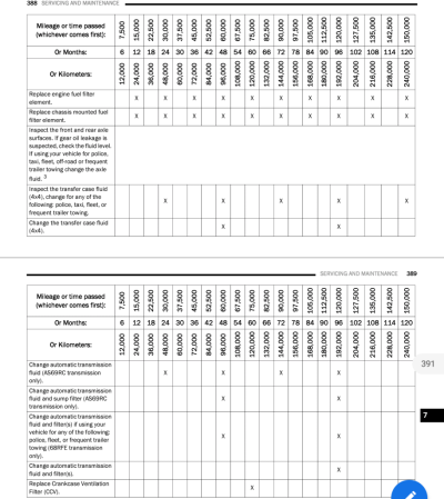

Here's you're quick reference, I've put them all in 1 spot, you'll have to blow it up or I can send it to you broken down into 3 segments if you need it bigger.

Here they are but separated

Thanks, BB. The only thing listed on those you gave, of the four I listed above, that the Dealership says I need to have done soon, is the transfer case. And your chart says change at 60K. Why is the Dealership saying I need to change it at 30K?
Also, brake fluid flush and change, front and rear differential change not on your charts.
I just changed all my fluids at 30k for the first time (, front & rear diff, tc, trans and filter and cooler line from tq convertor, radiator, plus oil & fuel filters every 14k or so), that might be way to early for some stuff but I wanted it to all be done since we tow a heavy rv. I'm guessing the stealership told you to do it at 30k to either make a couple grand from you or maybe at some point you mentioned one of the extreme duty considerations for early fluid change scenarios "change for any of the following: police, taxi, fleet, or frequent trailer towing". Plus I did the oil & filter and both fuel filters but those have been done multiple times at this point.
Your right though it could have been easier and put in the Manuel more clearly in 1 spot but I had to search numerous websites to source all the info on what mileage or time frame to change the fluids which took a good bit
