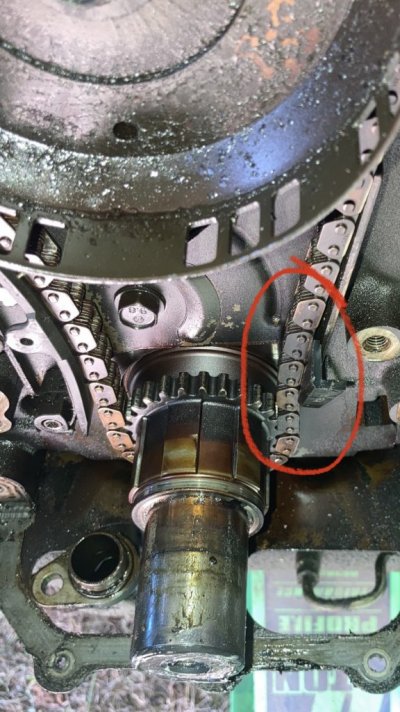

Ok so im starting this thread because im 90% sure my truck jumped timing and well I already pulled everything off the front of the motor except the timing cover. My first reason for posting, as im sure i will have more problems and questions before im done with this job. Well the worst thing was getting that damn harmonic balancer off unbelievable. I got a Chrysler puller from oriellys and the arms were not long enough to reach the spot where they supposed to attach so i brought it back, and got a regular 3 arm puller the 5 ton, and it wouldnt go on the grooves and also no matter what wouldnt go and stay hooked on the inside of the pulley because it has a ridge on it and kept slipping off, so i found a 2arm puller that is huge and would fit around the outside of the pulley and eventually was able to get it off. Unfortunately being on the outside of the pully it knocked some small chunks in a couple places around the outside that guides the belt. Its a brand new balancer so id like to not need to replace it but im wondering if that can cause problems like the belt falling off or what. Where i circled on the stock photo since i dont have my balancer near me right now, is about where some chunks off the side broke off flush with the belt grooves. I just dont wanna put it back together and on and then have to take it off coz it eats the belt or some ****..

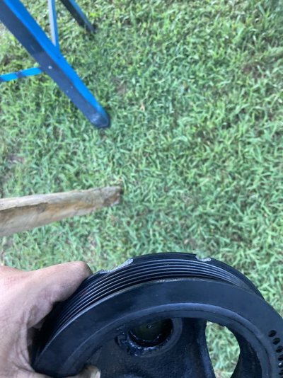

These are the pics of the damage that was done

So i got into my timing now and had to take the oil pan loose to get the oil pickup boot out, pan needs to be replaced anyways, if i can somehow get the thing out no luck so far.. anyways the timing is at tdc on compression stroke and it doesnt look like it jumped time so not sure why its running the way it is, or sometimes not running, except that the plastic guide (not the tensioner but the plastuc on the other side) broke in half and was floating around in there and the other half slid partially off.. not sire if that could or is causing my 45second of cranking to start problem as well as sputtering backfiring and stalling and the Starter sometimes couldnt turn the motor.. if anyone knows if that seems like it would cause it lmk coz it will be a little before i find out coz im waiting on parts..

The first picture shows a pretty large section that is broken. If you aren't going to replace it, you should at least grind all the sharp edges off of all the damaged sections.
