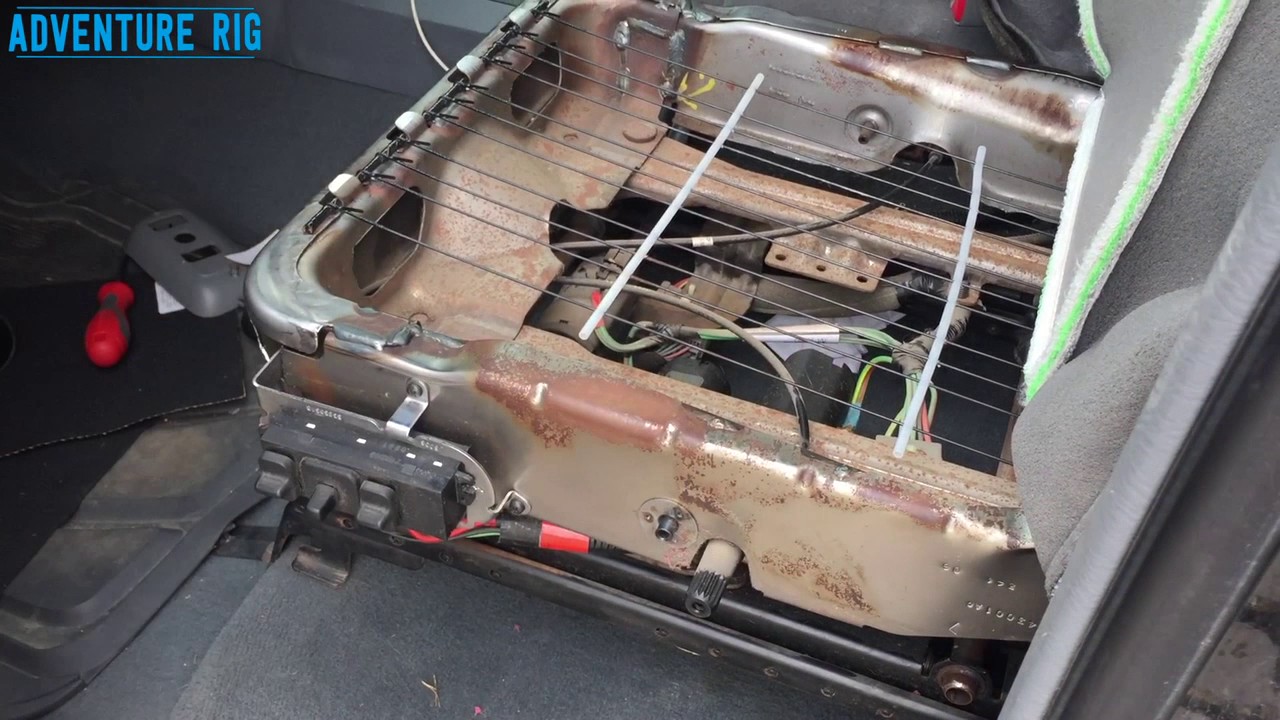

Would it be possible to remove a 13+ year laramie style front seats from the mounting brackets and whole assembly and reconnect them to a 2009-2012 laramie power assembly so that you get the new style seats on top of the old style controls ect?
My problem is that both heated seat function in my 2009 laramie is not working aswell my driver side bolster is ripped.
I'm hoping that it's the heating element in my seats thats problem.

Ram seats commonly wear at the bolster. There's a frame piece that put's pressure (pinches) the foam from sliding in/out 10,000 times... or whatever that number is since 2009.
You can buy replacement seat covers, foam and heating pad/s for your truck. There are some Y/T videos how to replace. Again Check Ebay and Amazon for replacement seat covers for your year. I replaced mine. Looks and feels like new!! One of the best things I did. And it was pretty easy. HERE is an example.
As for the heated seats, more than likely a wire in the seat heater pad has broken ...just from age/wear, and the pad needs replacing. It's pretty common. Universal heating pads are available pretty cheap. I would go that route. Much cheaper. Again, check Ebay/Amazon. But it could also be a relay or fuse ...even wiring, so don't forget to check those. But dollars to doughnuts there's a broken wire in the heating pad.

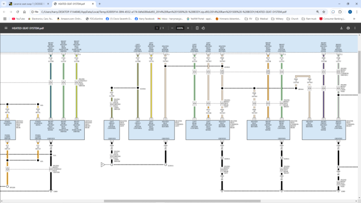

I hooked up mu Xtool scanner yesterday after work to clear a check engine light and the code I'm getting for the HSM is B1E991E front left heater control 1- Circuit Resistance Out of Range.
I never tested OHMS on any of circuits bc I'm unsure which wires are which under there, but that sounds like there is a high amount of Resistance in the circuit going to the pad.
Thoughts ?

More than likely your seat heat pads are open-circuit. Look for something like THESE...only for your Ram. You need to put in your tk's VIN and do a search on some site.
Or, Just google "seat heat pad, carbon fiber" Make sure you match up if yours are 3-position heat (or two), to get a matching pad/s. If you don't want to mess around with aftermarket, I see Mopar has them (not cheap!). Yeah, that stuff isn't cheap!
