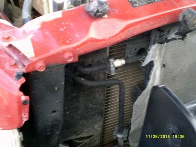

The hose on the right is what I'm needing, and can't find. It has an A/C fitting at the condensor & the suction-discharge assembly on the compressor, so I should be able to replace just that hose.
Shows the hose going around the radiator & to the condensor

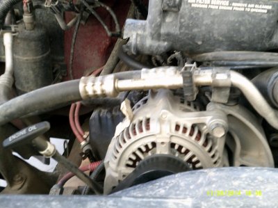

Here is where one of the A/C disconnect fittings are, to show what they look like
Shows the suction-discharge assembly on top of the compressor. I can get this part, but it doesn't include the discharge hose I need, only includes the suction hose which is part of the assembly.
Where it connects to the front of the condensor (top hose). And I've looked at a 2001, and it doesn't have this style of A/C fitting on the condensor or hose, so I doubt it'd work if I converted it to a 2001 manifold assembly.
